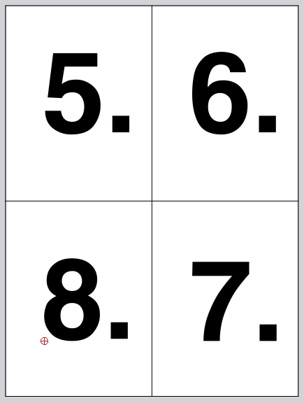

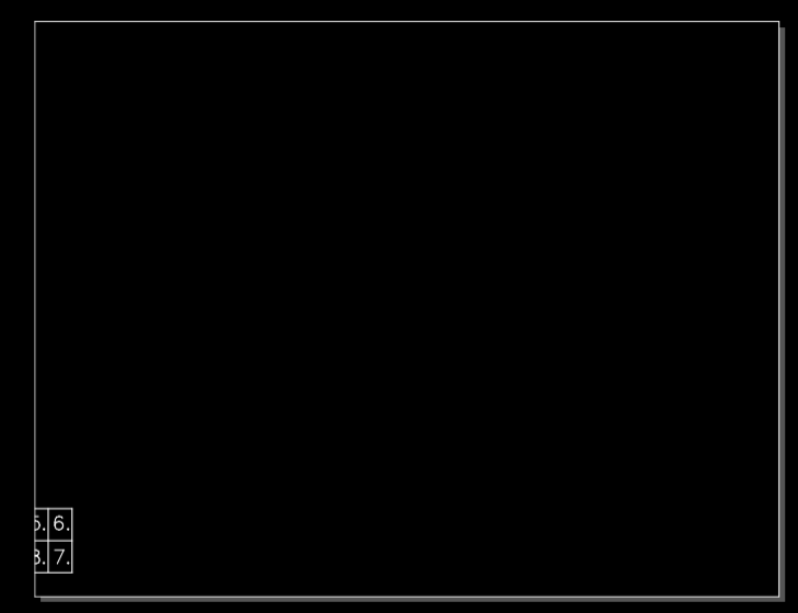

Hi ryancousins,
After I tried and failed to figure out what is causing this behavior I sett up a new drawing with similar settings. It shows the same problem in a AC software.
The drawing has 2 Layout Blocks, Arch C, 1:1. ACAD can only see one and ignores the second one completely!
I used a block to place it in a layout block. This block is rendered in AC on an absolute different position, the page is rotated bei 90°and the scale of the block is off.
QCAD layout block looks like this:
same drawing in ACAD looks like this:
I teste this in QCAD 3.20.0-pro and 3.27.8.0 - same result!

I don't think that you did a silly thing! But it is also possible that I do the same silly thing because I can't figure out what is going on despite I tried hard for hours ...ryancousins wrote: ↑Tue Oct 18, 2022 2:22 amI'm wondering what silly thing I might be doing that is preventing ACAD from seeing my block attribute text. Since my "Rep Plot" block contains several other blocks, I tried exploding that main Rep Plot block to see if that helped ACAD "see" the text in those sub-blocks but that didn't seem to make a difference.
@Andrew
Please have a look and enlighten us what we are doing wrong!

Husky: layout settings work completely differently in QCAD and Autocad, i.e. are not meant to be compatible. If you want to print in both, you have to set up in both separately.
