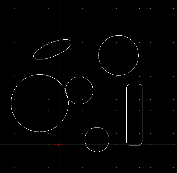

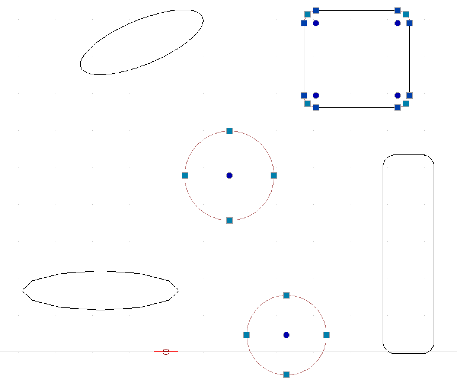

Initial selection:
The result after running the script:

Dacicusan,
Forgot all about this endeavor.
I then also have no files with tessellated segments.
I think you have to take a closer look at what is selected in the example of bergdesign.
You don't actually select the 'rounded' quadrilaterals, only the tessellated corners.
e.g. selecting a square would return a circumscribed circle.
The result of the tessellated ellipse looks indeed odd.
Given the explanation of bergdesign:
bergdesign wrote:
Thu Feb 18, 2021 5:55 pm
1) Filters the user selection to remove any entity that is not a line entity
2) Converts all remaining entities in the selection set to polylines using the native "polyline from selection" tool
5) For geometrically closed polylines, a three point circle is created using the start point, the 1/3 point and the 2/3 point
A) That doesn't add up at first glance.
B) What the start point will be depends greatly on the order of the entities IDs in the selection list.
Then shapes are first prepended then appended ... The outcome may vary.
The way back from segments to an ellipse is more complicated than a 3-point circle. :lol:
I used the file "ArcFromSelection example file.dxf" provided in this tread.

Dacicusan wrote:
Mon Jan 17, 2022 12:54 pm
Yes, but Broc didn't select the tesselated ellipse nor the horizontal and vertical segments of the rounded quadrilaterals.
Selected segments show faint red in the examples.

CVH wrote:
Mon Jan 17, 2022 5:27 pm
Ok, but the top-right rounded rectangle looks like it is selected and still it is resulting a full circle which it is incorect. Can this be fixed? Thank you.
