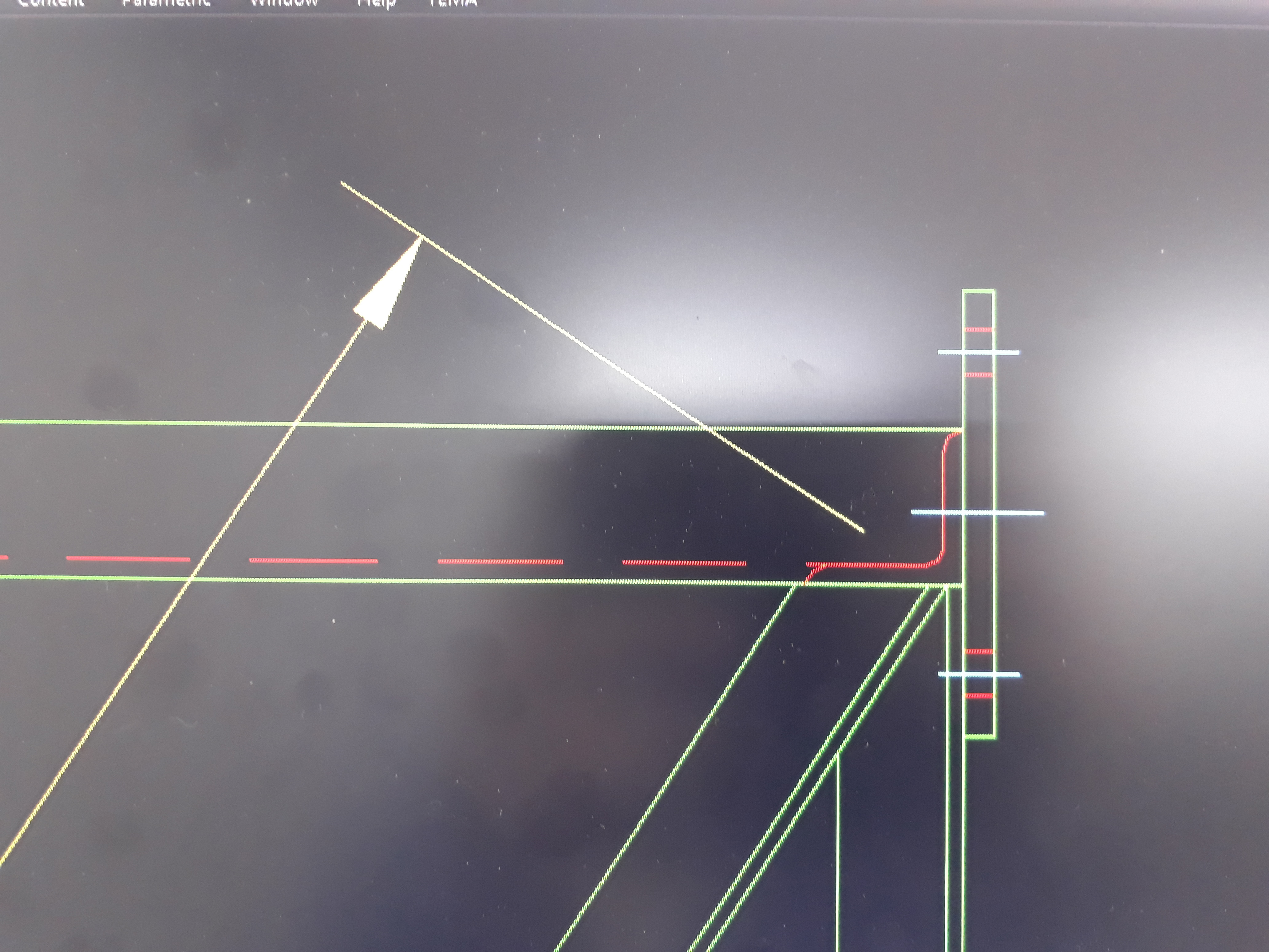

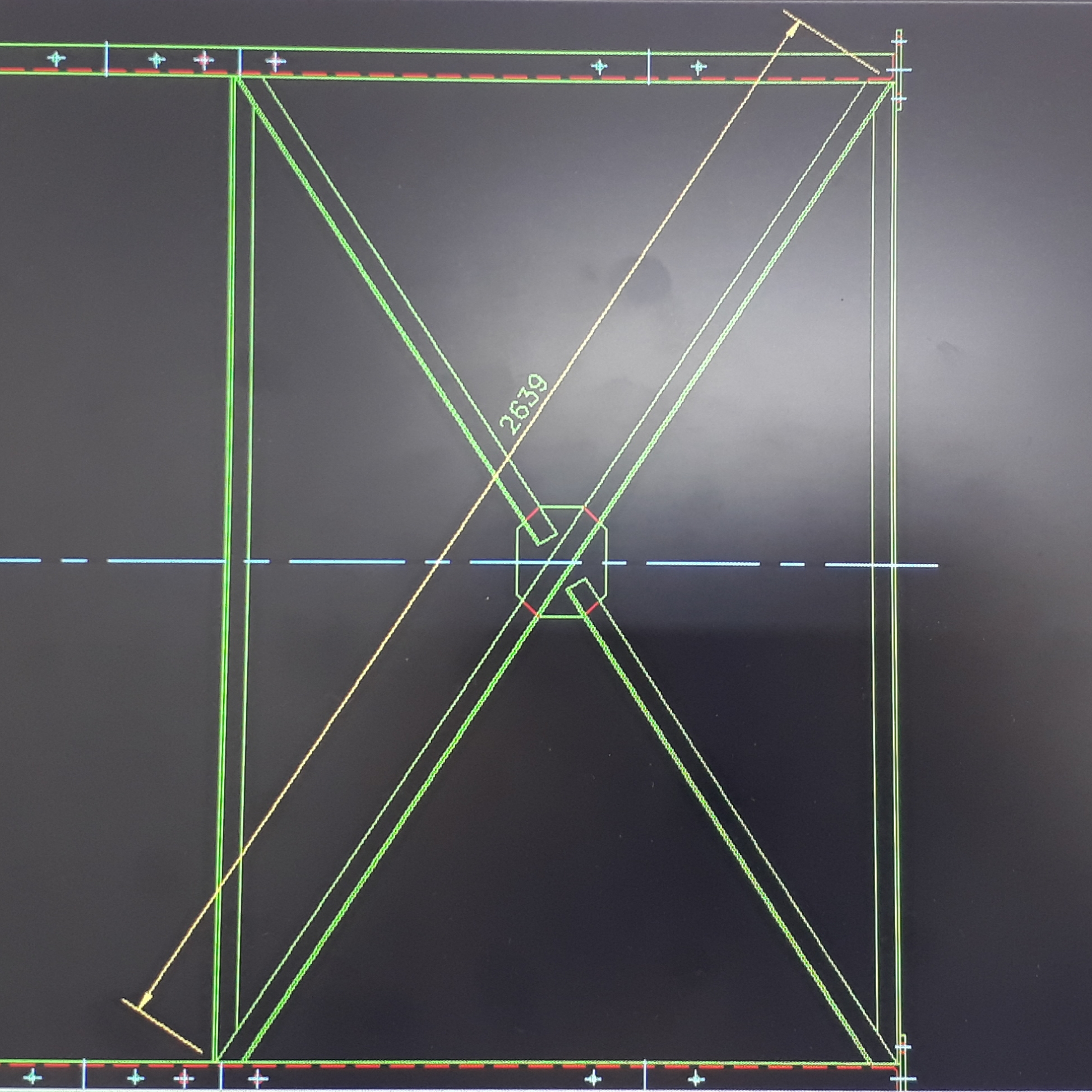

The point here is workflow productivity.
Just to give you an example, please see the following images.
Note that the inclined dimension is not aligned with a particular point to point on any line, so I can't use a simple aligned dimension. The dimension is parallel with them, or "horizontal". The goal is to obtain the total length of the beam.
On my job I deal with tons of this kind of dimensioning. This is just a simple example, but it is recurrent in bigger cases.
What would be the fastest way to do this? (Like in AutoCAD):
Invoque UCS command
Take two points of the desired angle on one of that lines
The UCS is now inclined
Make an horizontal dimension
Invoque UCS command
Hit enter key two times
UCS is now in the default angle again
Boom, 2 seconds.

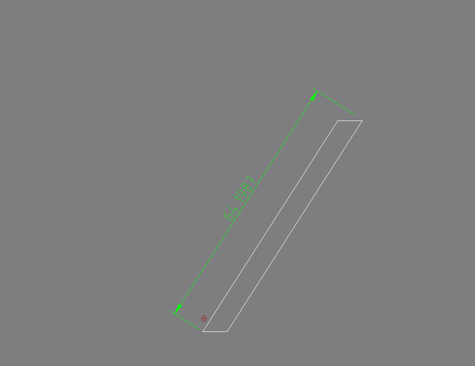

Do you mean something like this:
Screenshot from 2021-10-19 19.19.42.png (7.82 KiB) Viewed 13897 times
Where the dimension is aligned to the line, but two measured points are not?
It is easy to do using Rotated (Linear) dimension.
You simply need to specify line angle (you can find it and copy from line properties)
Hope I didn't misunderstand you :mrgreen:

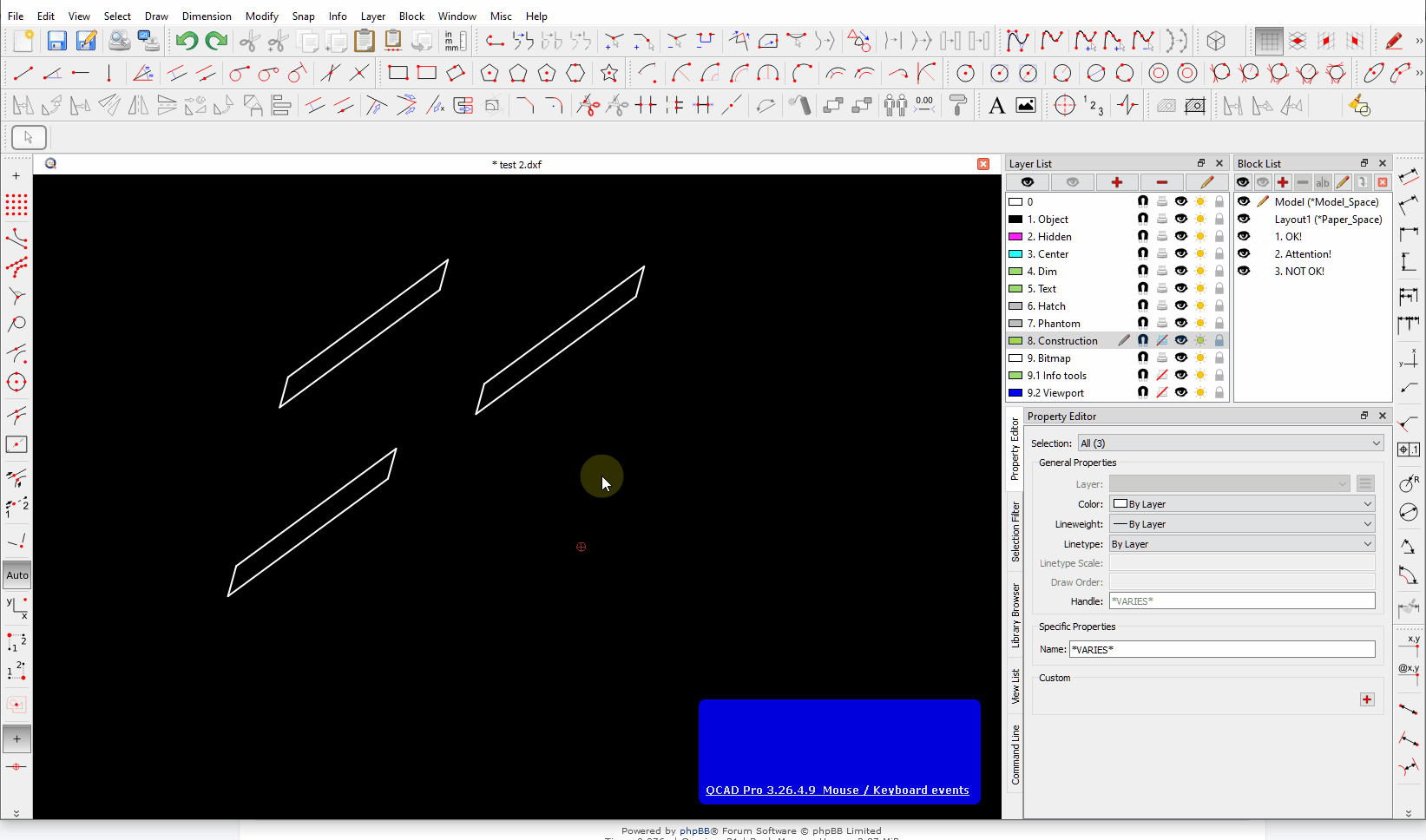

I have to disagree! Think out of the box. Rotate the whole drawing and you have the same result like using a rotated UCS. Why not just using a rotated UCS? Because QCAD doesn't offers currently a tool which can do that what means we have to use a similar working workaround ... :wink:
With other words: I agree with this statement! :lol:

Yes, you described the something similar to what I meant as the "first way". But, how long did it take to do this? My point here is productivity. In a 90 meter conveyor belt, it would be a time consuming.
And find a workaround is also my way to go.
