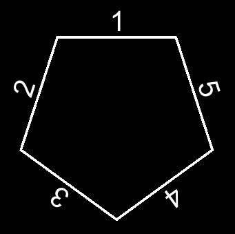

Example 1. I came up with three commands.
1. 'ucs', shortcut 'UC'.
This allows you to set a direction for the X axis.
Figure 1. The ucs toolbar. Figure 2. The command line prompt. You set the direction in the options toolbar, or you can select an entity and its angle will be put in the direction box. Not all entities have an angle associated with them. For example arcs, circles, polylines etc. do not have an angle property, so if you pick an entity that doesn't have an angle, an error message is shown in the command line, but you can continue to select another entity. Once you have set the angle you can click on the 'Tick' icon to run the command, or alternatively you can press the 'return' or 'enter' key on the keyboard to run the command.
The 'direction' is actually an angle which is aligned with the X axis. If you draw a line parallel to the X axis, going from left to right, it will have the angle represented by the X axis when the drawing is returned to its original orientation. In the example above, setting the direction to 72 will rotate the drawing so that side 2 of the pentagon will be horizontal to the X axis. Any lines drawn parallel to the X axis, going from left to right, will have an angle of 72 degrees. Lines going from right to left will have an angle of 72 + 180 (252) degrees.
(Note: you can use a mathematical expression in the box, so to get side 3 parallel to the X axis you can enter 144 or '2*72').
Also note that the value in the direction box is an absolute value, and not a relative angle.

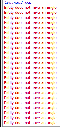

c.) If I launch this tool it looks like it reads the mouse pointer position. Unfortunately it start immediately even in "empty" areas of the drawing and reports

Yes, you are right. This is clearly wrong, so I have attached the fixed file, 'ucs.js'. Replace the existing file in the 'ucs' directory.Husky wrote:c.) If I launch this tool it looks like it reads the mouse pointer position. Unfortunately it start immediately even in "empty" areas of the drawing and reports
The error message, which now works correctly, is shown if you pick an entity that does not have a getAngle function.Husky wrote: d.) the tool works also with single line "entity input" but I don't have the info or an alert that it doesn't works with polylines etc.

With modifying or the pseudo USC (Usc.js), a lot of math is used to alter every reference of every entity.
Every next pseudo USC state again.
In the end there will be a large accumulated floating point error and you never get back to the initial state.
It's fine for a few MV/RO back and forth.
It's fine for a few states with 'Usc.js'.
And for small entities and near the origin.
Just try it out and the regular pentagon (higher up) will never be regular again.
Especially far from the origin or with larger numbers in general.
1ULP will become near to or will exceed fixed tolerances in QCAD of 1E-12, 1E-9 and so on.
Only a few mathematical functions are correct up to 1ULP. For some that can be up to 10ULP.
Accumulated even much, much more.
The problem with uncertainty is that it is never certain.
You will never know and you never will be able to correct it.

- The getAngle() issue is not worked out for polylines straight segments nor for most curved forms.
Although it would work with Ellipses (general orientation), Text based, Hatches and Aligned Dims.
