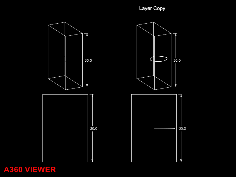

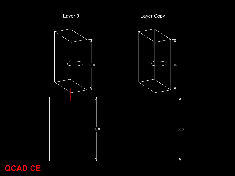

The attached DXF opens fine in QCad, but fails in Autodesk A360 viewer.
So apparently QCad is more forgiving than Autodesk A360 viewer. Is there a way in QCad to examine the DXF file for any "warnings" or malformed input, or can anyone see something obviously incorrect with this file? Removing the SPLINE entities results in it working in Autodesk 360 viewer -- so apparently there is something wrong in the SPLINE entities.
I've attached the text-format DXF file as well as a screen capture of how it looks when opened with QCad.

I can open your dxf in the Community Edition but QCAD Pro and A360 Viewer fails.
If I open your test file in CE - save it again - then I'm able to read it correct in Pro.
Working with QCAD CE - copying all entities from Layer 0 to a new one will make splines and text readable for the A360 Viewer.

FAQ:dcooper8 wrote:The attached DXF opens fine in QCad, but fails in Autodesk A360 viewer.
