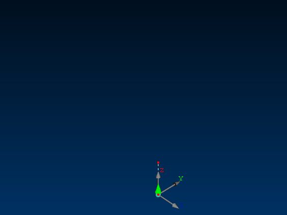

The first profile looks like this: blue = milling at Feedrate or plunging, red = traversing
Optimization should now rather focus on proper chip load, Feed & Speed.
For a 2 flute cutter d3mm softwood chip 0.1-0.15 at 10000rpm the Feed should be between F2000 and F3000.
That would turn out to about 3x faster or a running time less than 20min.
