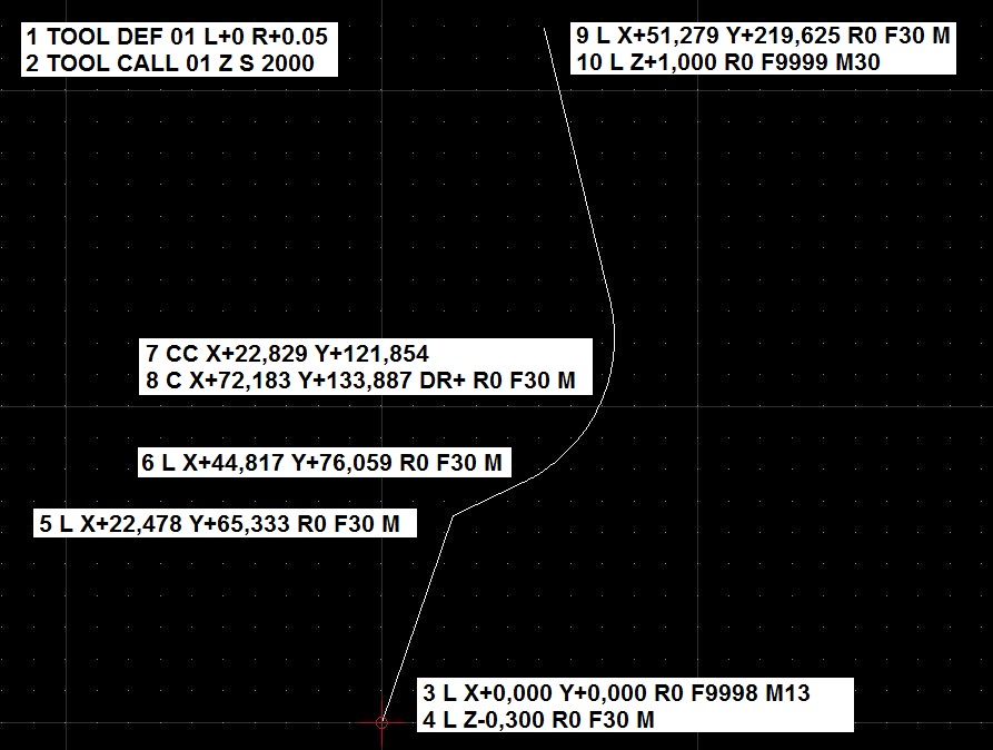

1 TOOL DEF 01 L+ R+0.05
2 TOOL CALL 01 Z S 2000
3 L X+0,000 Y+0,000 R0 F9998 M13
4 L Z-0,300 R0 F30 M
5 L X+22,478 Y+65,333 R0 F30 M
6 L X+44,817 Y+76,059 R0 F30 M
7 CC X+22,829 Y+121,854
8 C X+72,183 Y+133,887 DR+ R0 F30 M
9 L X+51,279 Y+219,625 R0 F30 M
10 L Z+1,000 R0 F9999 M30

Re: comma as decimal separator in cnc code
I've attached another update with forced output of L for every linear move.
- Tnc145.js
- (2.48 KiB) Downloaded 2669 times
- Posts: 17
- Joined: Sat Oct 03, 2015 11:27 am
"L " for linear moves works fine now.
Line3 is still missed as output
3 L X+0,000 Y+0,000 R0 F9999 M13
- TNC145 dev.JPG (120.61 KiB) Viewed 101446 times
