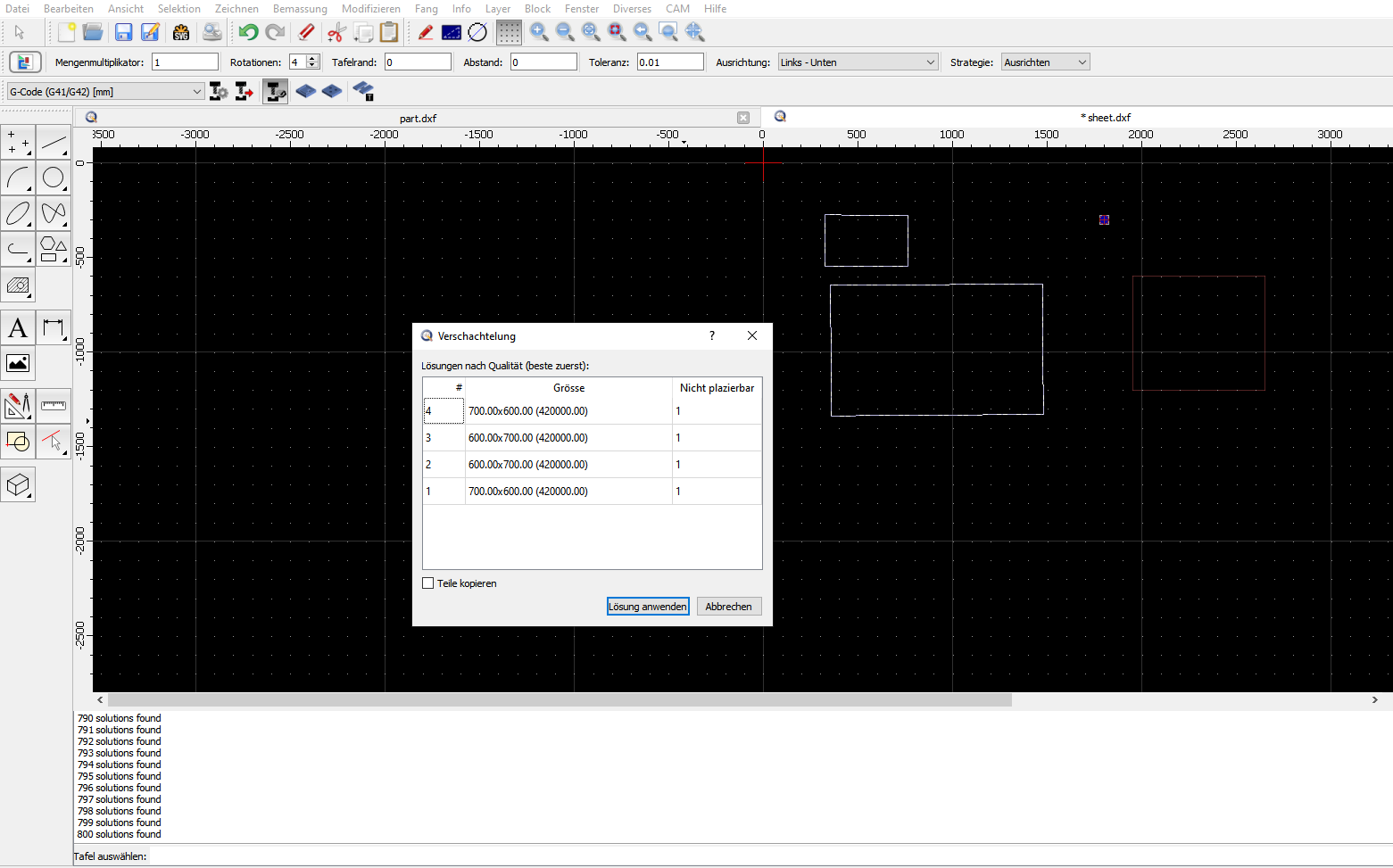

hi,
think i detected a bug in nesting:
when trying to nest a single part into two sheets, where one of them ist to small for the part and its position is more "left" than the bigger one, then the nesting ist not possible, although theres enough space in the bigger one.
Scrrenshot an example dxf in attetechment.
