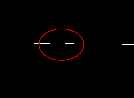

Hi Matthias and welcome, there is no specific tool to search and find a broken line as it were... but here's a sneaky little workaround that may help you outM.Eggert wrote:So I'm sure that there is also a solution, How to check a broken line?
1. Here's your drawing, but I have deliberately broken a line!
2. ... and here it is.
3.Go to the hatch tool and try to create a Hatch, as you may know a complete unbroken boundary is needed for hatching ... but lets see what happens.
4.It wont hatch - as expected and it gives the coordinate location in the command line for reference and highlights the issue in your drawing. Once fixed you can try hatching again if there are any more broken lines (unclosed loops) it will show them to you as QCAD finds them.
5.Loop closed/line fixed and a successful hatch created
Hope this helps.
