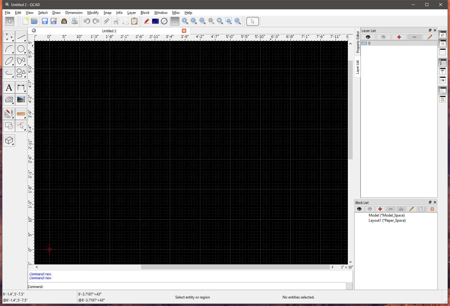

				Hey, my layer list just isn't working properly.  There is supposed to be an eyeball and a lock icon on each layer.  Its missing on my PC.  Strangely enough, if I click around on the empty space, I can change the layer visibility if I click on the right spot. So it's almost as if the icons are present, but not being rendered.
- Screenshot 2017-01-16 23.10.17.png (120.83 KiB) Viewed 18955 times
Please help.

				Re: Missing icons on the layer list
				Posted: Wed Jan 18, 2017 8:42 am
				Unfortunately, I cannot reproduce the problem here and we didn't have any similar reports so far.
Can you please try to re-install QCAD Professional?

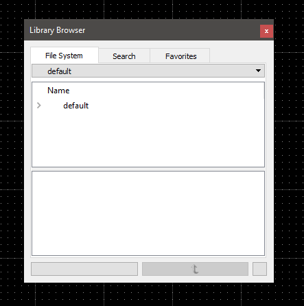

This is not a problem unique to my particular PC, this is a problem with the way QCAD uses QT, specifically qtsvg.
I have the same problem in both layer list and block list, and behold my Library Browser:
- Capture.PNG (9.2 KiB) Viewed 18128 times
I'm looking at the source now.  My best guess is that one of the many other open source programs I have installed have used a version of QT that is interfering with the SVG rendering.
				Posted: Thu Nov 16, 2017 4:22 pm
				by dhowland
				QT_PLUGIN_DEBUG didn't produce any output.
However I finally found the program that was interfering with QT. It was OpenShot. It set QT_PLUGIN_PATH in the environment.
I was going to recommend that QCAD always open plug-ins from it's own install, however according to the QT5 documentation:
Note: QT_PLUGIN_PATH should not be exported as a system-wide environment variable since it can interfere with other Qt installations.
Therefore I will consider it a bug in OpenShot and report it with them.
