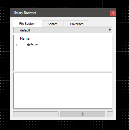

This is not a problem unique to my particular PC, this is a problem with the way QCAD uses QT, specifically qtsvg.andrew wrote: If the above does not work, I'm afraid this would be a problem unique to your particular installation of Windows / QCAD. Please contact me for a refund.
I have the same problem in both layer list and block list, and behold my Library Browser: I'm looking at the source now. My best guess is that one of the many other open source programs I have installed have used a version of QT that is interfering with the SVG rendering.
