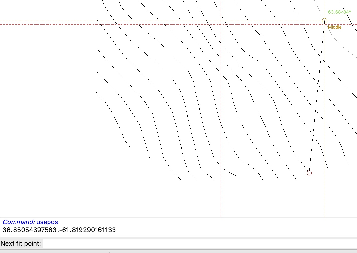

hi andrew,
Im trying to do the same process you described in five steps on a mac with pro versione 3.27.1.
As i give the command "use position" the program draws the FIRST point and then wait for the following, not using other point.
I can't guess what I'm missing.
thank you for your reply and this awesome program !
daniele

- Posts: 8772
Re: Polyline to spline
This preference is now available under:
Edit > Application Preferences > Info > Store Positions > Polylines
Check the option Store Nodes.
Then proceed as before to draw a spline with fit points from polyline nodes:
1. Select the polyline
2. Misc > Information > Store Positions
3. Draw > Spline > Spline (Fit Points)
4. Misc > Information > Use Positions
5. Escape

- Posts: 5
- Joined: Mon Dec 12, 2016 11:59 am
thank you. I did miss that !
