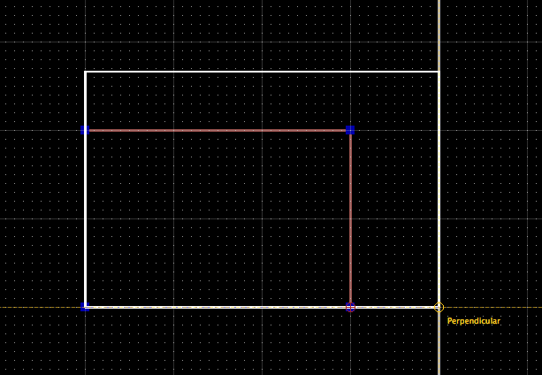

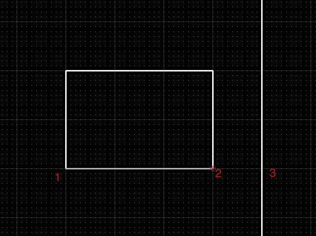

Clive wrote:maybe Andrew can elaborate and give us some examples where this may be useful!
Sure.. Consider the rectangle below. It has to be scaled up, so the right side aligns with the vertical line. 1 is the center of scaling (1st reference point), 2 and 3 are the reference points chosen after the scale dialog is shown.
Screen Shot 2014-05-30 at 15.36.35.png (18.32 KiB) Viewed 5626 times
Screen Shot 2014-05-30 at 15.40.15.png (15.96 KiB) Viewed 5626 times
