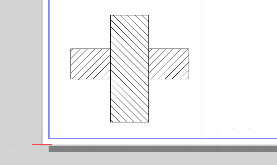

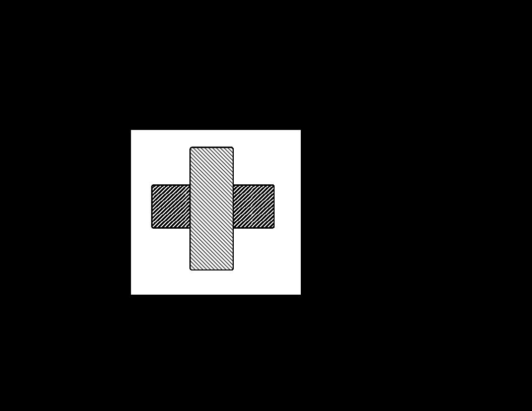

Here I am again, this time with a really puzzling issue. Using black-and-white drawing, I am trying to show overlapping entities that have hatches instead of solid fills.
In regular drawing mode, it looks like everything is good to go. But in Print Preview, my drawing is not displaying correctly--no matter how much I have edited layers, Application Preferences or Drawing Preferences. Seems like I need to make the hatch be opaque somehow. Please see image below to understand what I am trying to do (image not created with QCAD). Horizontal rectangle is behind vertical rectangle. Any suggestions?

Seems easy enough ...
It is a combination of:
- A back hatched area solid in paper color with drawing order 1
- A horizontal hatched area with pattern ANSI31 at 0° in Black with drawing order 2
- The horizontal contour in Black with drawing order 3
- A vertical hatched area solid in paper color with drawing order 4
- A vertical hatched area with pattern ANSI31 at 90° in Black with drawing order 5
- The vertical contour in Black with drawing order 6
Then it is important to not prevent white on white and black on black for printing.
See Application Preferences .. Graphics View .. Appearance .. Color Adjustment.
Remind that this has a global effect on all entities.
The key feature is the drawing order.
Layers don't influence the drawing order.
Don't think of them as a kind of drawing surfaces stacked on top of each other.
Layers are mainly used to control the attributes of entities that live on them.
Tutorial: Working with Layers
Perhaps the new feature Wipeouts (solid fill in background color) can be of any use.
See QCAD Changelog for the upcomming release (>3.30.1)
