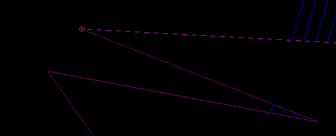

Other issues:
A: I understand that the visible frame is governed by the attributes.
Still I have a question with the used color and Linetype when not visible.
Similar as auxiliary shapes would be appropriate, using a continuously polyline pattern too.
- Odd Frame Linetype.png (2.29 KiB) Viewed 55237 times
B: This placeholder is also printed in some cases ...
It depends on the order of things.
Setting the Wipeout on a non-printable layer is not really an option
