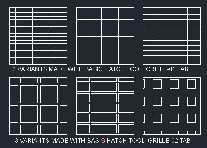

- Weatherboard Hatch.jpg (18 KiB) Viewed 1764215 times
- Grille-01 - Grille-02.jpg (44.96 KiB) Viewed 1764216 times

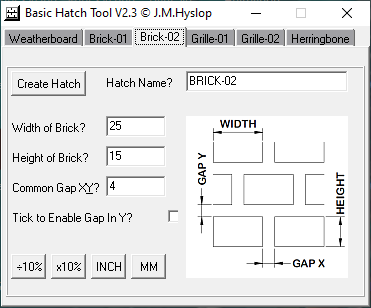

- Brick-02 Tool.jpg (52.84 KiB) Viewed 1764262 times

V2.1
BRICK-02 & GRILLE-02 Now Have
Option to Change Gap in Y
PS. Updates Available LOOK FURTHER ON

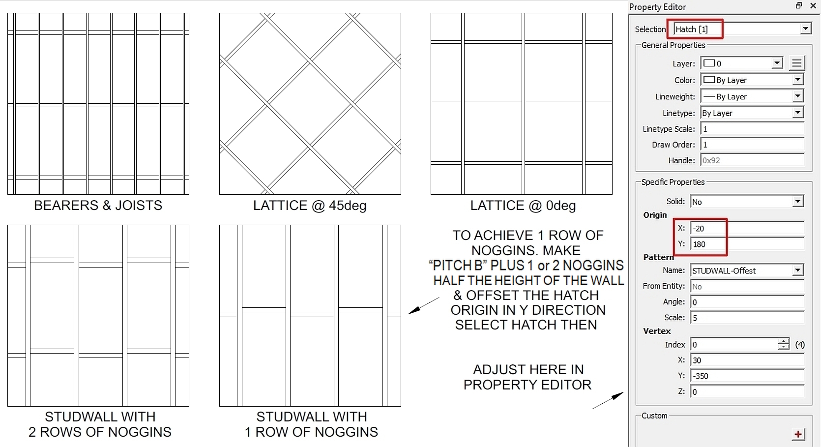

Tutorial on Using The StudWall Tool Now in the zip file and also separately
for those who have already downloaded the Tool, PDF 2 Posts Down
PS Updates Available LOOK FURTHER DOWN Here are some other things you can make with " Basic Hatch Tool " Hatches
Weatherboard = Decking / Paneled Walls / Flooring / Equally Paced Lines ( Make Radius Half of Pitch )
Brick-01 = Paving / Roof Tiles / Flooring / etc
Brick-02 = Paving / Roof Tiles / Bathroom Tiles / Flooring / Lattice / Decking / etc
Grille-01 = Wire Fences / Paving / Tiles / etc
Grille-02 = Fences / Paving / Tiles / Decking / Flooring / Lattice / etc
Herringbone = Pretty Much as is with limitations at the moment, length must be divisible by width.
StudWall = Decking / Lattice / Bearers & Joists / etc
I also adjusted the X & Y Origins to make it fit better in the square box, if the hatch touches the edges of the hatch area you can dimension it to find out how much to move it if required, you can also use keyboard hotkeys IP (Menu> info > distance point to point)
Please Read the BTH-Usage.txt file supplied with Zip, It contains important information about
using the Tool..
Enjoy
Just Updated V2.4 to V2.4.1 Added Message "Incorrect Offset Entered" in StudWall Tab
You can continue to save but it will be incorrect, Just select NO on save and fix incorrect input..
The next version will not give you the option to save if you enter a negative value but
I need to create a subroutine for this on all patterns so I'll fix on next release
Cheers
John Hyslop
PS Just corrected name of PDF file to Studwall instead of SudWall
