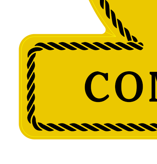

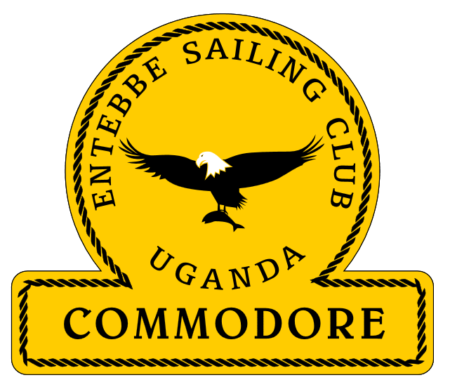

It started with an order of my old mentor in engraving.
He is retired and lives partially in Uganda these days.
The order was to make 14 badges as relation gift.
The first pic is the design I got from him, the second is what I proposed.
I followed a tube on how to flex the rope manually.
Drew 1 corner with Qcad and cloned it 3 times.

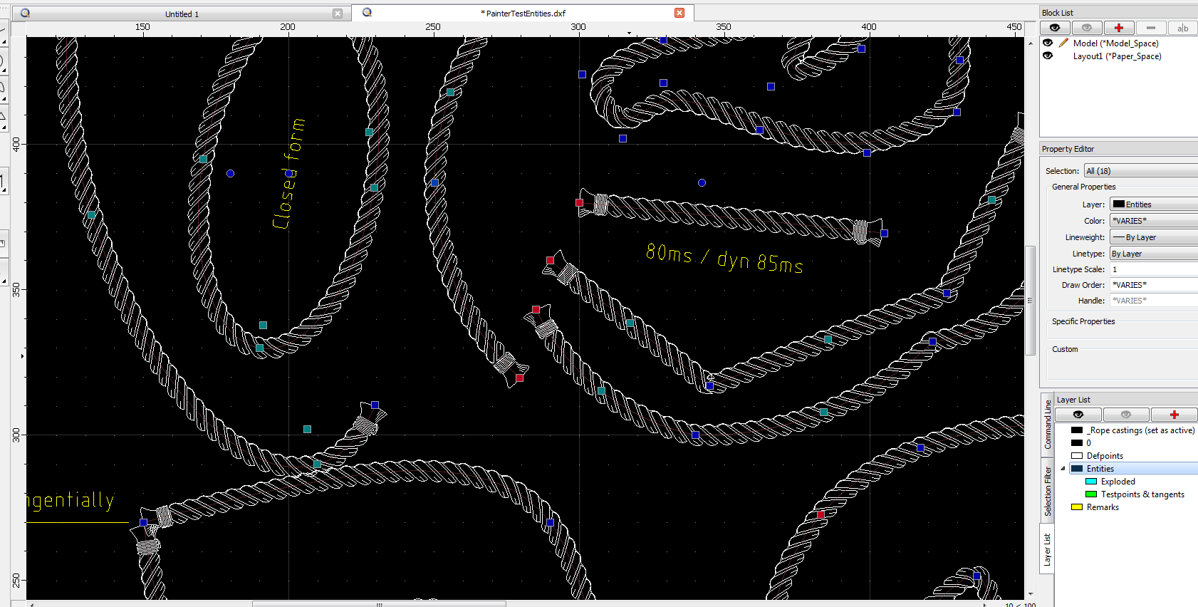

The script adds an entry to Misc| Script Examples | Mathematics | ..
The script mimics a roller stamp that travels along the selected base curve.
Pictures say more then words.
Command started with all selected.
Resulting castings

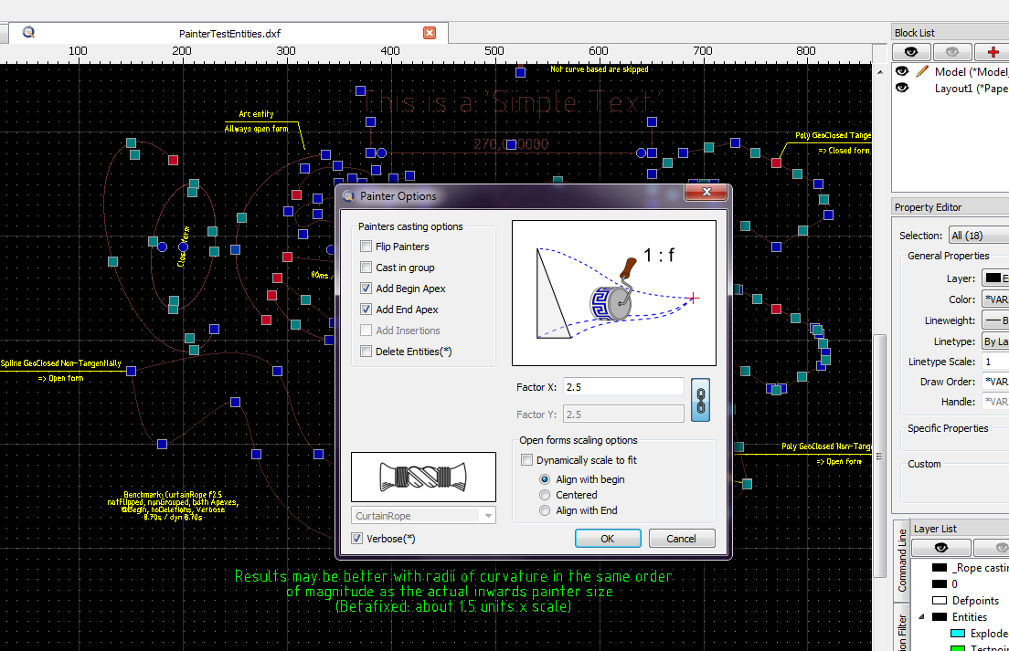

Flexpainter Beta v0.40
point4 is in essence a full rewrite of the casting core envelope.
Painters are base9 in analog of the CXF fonts. :!:
Definition width is changed to 9 units, non-restrictive.
The user can choose width, length and stepsize in actual document units.
Aligning is now properly supported, with sub-chains as well globally as locally.
(What was of no issue for the 'CurtainRope' because it is slanted) :o
Solved the issues with painter definitions situated on the margins.
The problems occured at entity endings of splines and polys.
I'll post a seperate topic on that. :|
Added several simple but usefull painter sets besides the 'CurtainRope' painter.
These were primarily used for testing.
The sets definitions are still hardcoded in the script file. :|
One catch however: :!:
I am stuck in the code with selecting painter sets in the Dialog. :oops:
Andrew has promised to have a look. :?
I didn't see any gain in sending him a non functional bunch of code.
It took me a while to have it running and to clean out crap code.
Andrew, I've included a problem description.
For now the workaround is to edit the Flexpainter.js:
Activate the desired set at:
lines 1043-1054
And reboot Qcad, sorry for that. :oops:

The main casting loop is fully revised and better prepared for future enhancements.
For convience some part is cutted up in little detached if blocks.
What has lead to doubling the same if's, off course. :)
The pro was that applying rules and methods and the order of became more flexibel.
It will allready support insertions and sub-chains in testfase.
Treatment of painters adapt to:
a) Over-stepped: step > length
b) Box-stepped: step = length (in se !=a and !=c)
c) Under-stepped: length > step eg. slanted: 'CurtainRope'
Set definitions are categorized in intended purpose.
Not limiting that combinations of parameters may alter the actual type & purpose.
Some groundrules had to be aplied: e_ugeek
1) Painter defs are confined within their lenght and start at the leftside.
2) In essence a complete 'painter' is scaled and stepped.
If this 'painter' ends with a void in any way, the void is part of the 'painter'.
Any chain of repeated painters then ends in one such void.
Casting finishes near the end of an entity.
A 'reversed look' is only achieved on a reversed entity, and not by aligning.
For now only splines were used for the artistic look and the natural behaviour.
Straight splines with only two points are merely Line entities.
One thing lead to more and additional datatypes will be added later:
* Point, Line, Arc?, Circle?, Poly, Hatch?
Several pitfalls here:
* Points are used to cast splines globally along the base entity.
* How to morph a Poly, a Hatch?
Allready the points used for global fitpoints were called 'Dots'
And luckily the first four don't need morphing.
Again, much more in detail it can be viewed is the script file itself. :mrgreen:

On firts load or on document switch the tool shall
auto adapt to different document units.
There is a story about that this morning, you may want
to read in the note to Andrew.
Repared the 'flip painter' that was broken with the transition to units.
Repared the spinnerbox for 0-100% shifting that was not spinning. :oops:
Enhanced the painter definitions types:
- Local: Point, Line, Spline, Arc, Circle, Poly (+bulge!?)
- Global: Spline, Poly (no bulge yet)
Painters are base9 in analogue with the CXF fonts.
Definition width is 9 units, non-restrictive.
Added some more painters sets.
Added all preview icons of these painter sets.
The icons are all in a sub-folder 'Icons'.
The idea where I am playing with is to split the definitions into files/scripts.
Any ideas or preferences someone? :idea:
I see that Flexpainter 0.34 is allready included on Github. :shock:
This zip package with version 0.41 is intended to be extracted to:
QCAD\scripts\Misc\Examples\MathExamples\
Included is a subfolder 'FlexPainterTemplates' with 2 dxf drawings.
One is a tutorial on how the painter is constructed, and one with a bunch of test cases.
On a win system it might be beter to move these out of the protected OS portion as Admin.
While you are at it and if you may have used 0.34:
Clean anything related to FlexPainter in <QCAD3.ini>.
You will get what I mean by this. Same as starting with a clean slate.
Changing to units after 0.34 the UI naming stuff has changed accordingly.
Again, much more in detail can be viewed in the script file itself.
