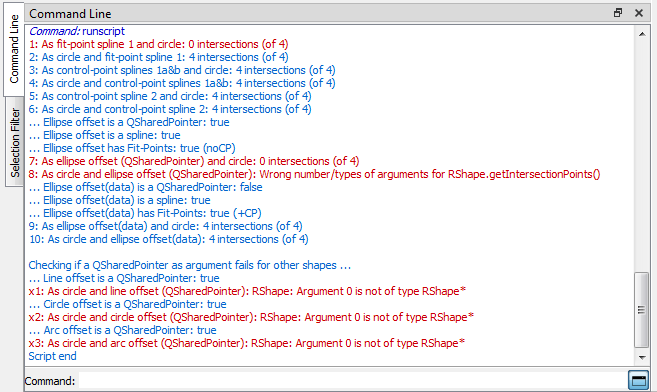

Andrew,
I extended the test script a little further (FS#2620)
The reported results on the Command History:
Case1 and 7 are reported in the related bug report on Bugtracker.
There are NO intersections found for a Fit-Point Spline and a circle.
For Case1 a newly created RSpline with Fit-Points, for Case7 an offset to an ellipse = Fit-Point Spline (QSharedPointer)
Swapping the shapes works for Case1, see Case2 but gives a critical error for Case7, see Case8.
This is of no issue with Control-Point splines, see Case3 to 6.
Excluding QSharedPointers, spline 1a&b are RSpline's form a split and spline 2 is a newly created Control-Point spline, an RSpline.
:arrow:
The real solution for QSharedPointers as argument of shape.getIntersectionPoints(other) is to 'strip' the QSharedPointer with getPtr(obj).
Or Qt5 based with:
if (isFunction(obj.data)) {
    obj = obj.data();
See Case10
And then it works both ways, as circle vs spline like in Case2 but in contradiction with Case1 also as spline vs circle.
The hint here is that this Fit-Point spline reports to have Control-Points besides Fit-Points:
... Ellipse offset(data) has Fit-Points: true (+CP)
It is no longer a Case1 or 2 but rather a Case3 to 6.
Case x1 to x3 are similar tests with QSharedPointers as argument of shape.getIntersectionPoints(other)
Expecting 2 intersections for each but they all fail critical.
In the light that every clone of an object will be a QSharedPointer in the near future (Commit 064fb09) ...
... I propose that RShape::getIntersectionPoints is able to handle these as argument.

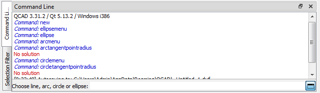

Not entirely by luck ArcTPR looks for the intersection of a parrallel curve and a circle ...
... Avoiding a critical error as with Case x1 to x3 and Case8 ...
... But that doesn't solve things for Case7 (or Case1) :!:
Hence 'No Solution' for a tangent arc AT (or circle CTP) to an ellipse (arc). :(

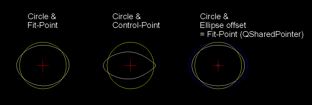

Visualization of the shapes involved for Case1 to 10:
The test script that can be run with: Misc .. Development .. Run Script (XC):
testQSPScript.js
(9.85 KiB) Downloaded 444 times
The code of this script in textual form:

var isQSP = isOfType(aOffset, RArcPointer).toString();
EAction.handleUserInfo("... Arc offset is a QSharedPointer: %1".arg(isQSP));
try {
    // Get intersections of RCircle and line offset, expecting 2:
    var ips7 = circle.getIntersectionPoints(aOffset, false);
    // Report the number of intersections on the Command History:
    EAction.handleUserInfo("x3: As circle and arc offset (QSharedPointer): %1 intersections (of 2)".arg(ips7.length));
catch(err) {
    msgShort = "RShape: Argument 0 is not of type RShape*";
    EAction.handleUserWarning("x3: As circle and arc offset (QSharedPointer): %1".arg(msgShort));
// Report end of script (If we get this far):
EAction.handleUserInfo("Script end");
Posts: 4879
Re: Issues with QSharedPointers
Post by CVH » Tue Jan 07, 2025 2:37 pm
Update:
The method RShape::getIntersectionPoints() remains as it was.
Newer implementations tend to use shape.getIntersectionPoints(getPtr(other), ...) (Commit 02a8641)
Avoiding a QSharedPointers as argument if that possibility exist.
... Those users with custom built scripts know what to do again. :lol:
I have to wait for the new release to test if Case1 and 7 are solved meanwhile ... Rather unsure as it relates to Fit-Points splines.
Posts: 4879
Post by CVH » Wed Jan 08, 2025 11:31 am
Even correct handling of QSharedPointers didn't fix things.
Conclusions where not optimal because the nature of the shape alters on a second attempt.
A further update in a consecutive topic
