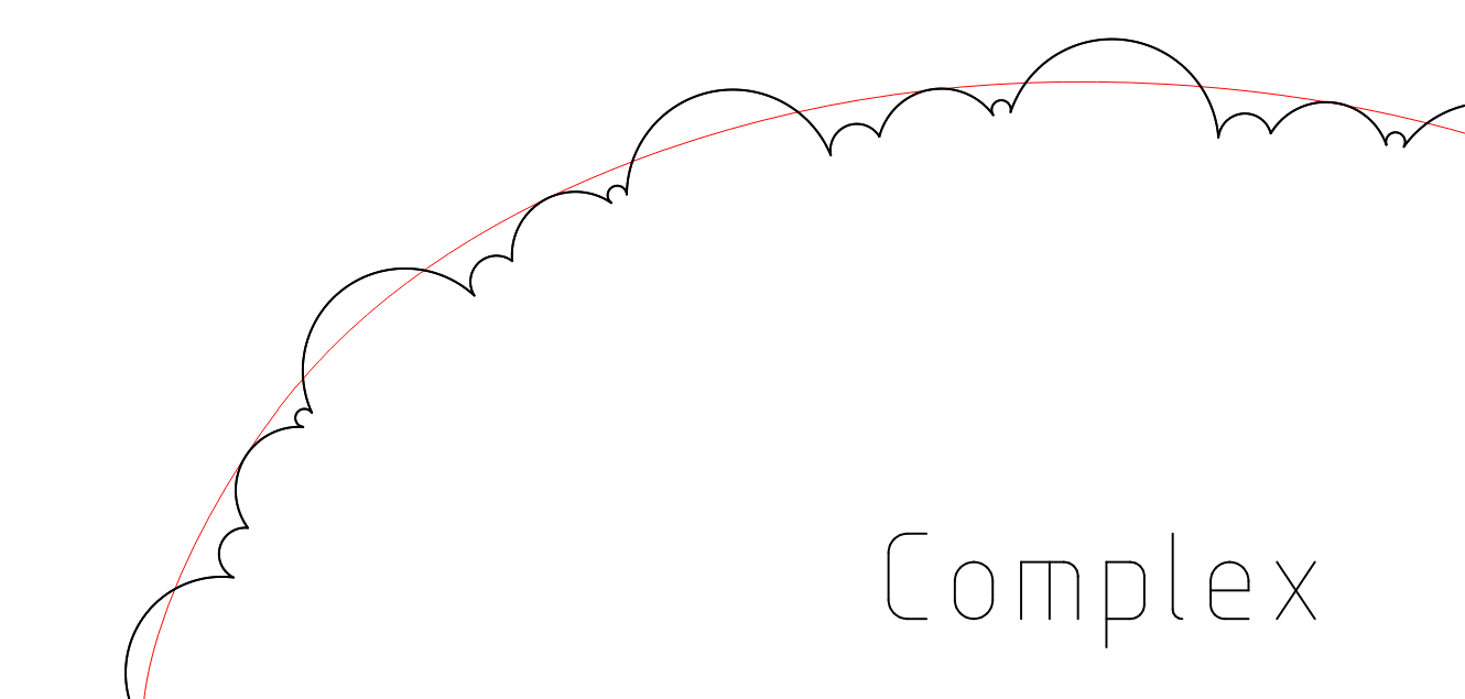

Revision Clouds by FlexPainter
In respons to:
https://qcad.org/rsforum/viewtopic.php?t=6131
https://qcad.org/rsforum/viewtopic.php?t=3519
https://qcad.org/rsforum/viewtopic.php?t=846
Coded some clouds painters.
Will be included in a next release.
Regards.
Regards.

Was this ever included ? I can't see a cloud option in the Painter options dialog box.

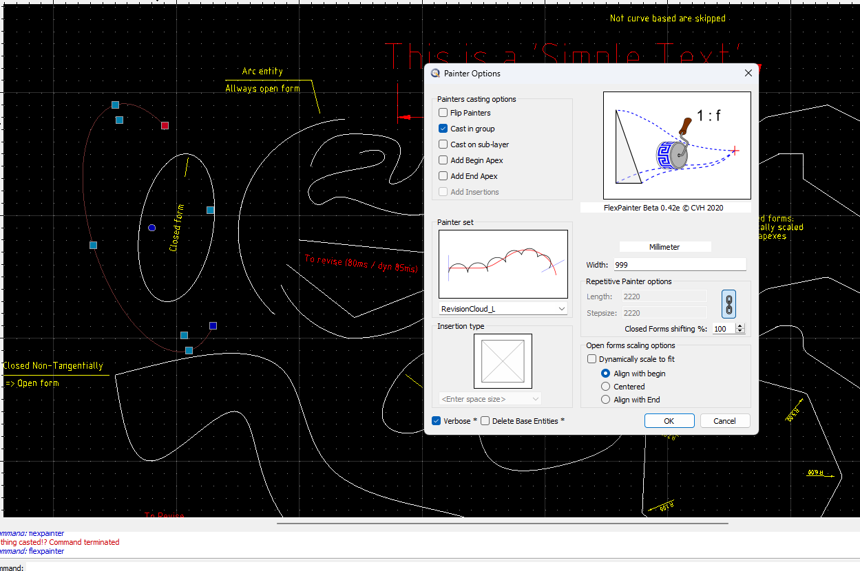

- Posts: 3
- Joined: Tue Aug 30, 2022 5:14 pm
Re: [Updated beta 0.42e] FlexPainter beta 0.34
It's been some years since I've used Flexpainter - I'm obviously missing something basic - but no matter what I do I keep getting the error message Nothing Casted command terminated.
I'm using QCAD 3.30.1 BTW
I'm just trying to create a revision cloud around a selected object.
Thanks for using FlexPainter.
Your painter width is set to 999mm also meaning that 1 painter set is scaled up to be 2220mm long.
FlexPainter won't cast anything below 3 copies of a painter set, the upper limit is 9999 copies.
The selected entity in the example drawing is about 325mm long.
I know that it is an ambiguous used terminology in the beta version, but clearing "Verbose" would list more details on the Command History.
- Version Beta 0.42e
Painter set: RevisionCloud_L
Width: -999
Length: 2220
Stepsize: 2220
Ellipse Too short. Skipped!
Nothing casted!? Command terminated
Hi CVH
Thanks, sorry for being so dense. I've also worked out now (relearned
) that I have to draw a shape around the object I want to highlight and then flexpainter converts that shape into a revision cloud, and the flip option will determine what side of the object line the cloud bumps appear on.
