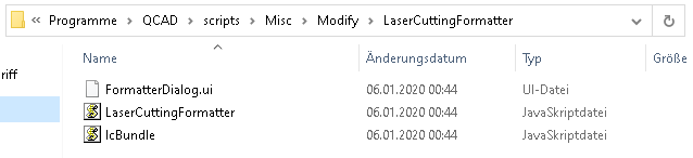

I just tried it on Windows 10. It works as expected. Please make sure your install-directory looks like this:

Post by Husky » Mon Jan 06, 2020 7:47 pm
Why is my recently done download named lc-qcad-master and your installation LaserCuttingFormatter? Looks like I don't know where to download the actual version ...
RR88
Full Member
Posts: 51
Joined: Sun Apr 29, 2018 7:04 am
Location: Leinefelde
Re: Plugin for laser cutting
Post by RR88 » Mon Jan 06, 2020 7:50 pm
You have to unpack the zip-file located in the dist-directory :!: :!:
Arch Linux, QCad 3.22.0 Prof.
Post by Husky » Mon Jan 06, 2020 10:57 pm
Ok, thanks.
